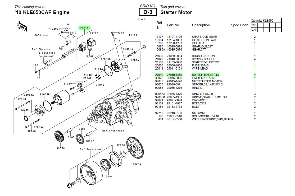

From PartZilla Link HERE this Kawasaki 27010-1446 SWITCH,MAGNETIC fits the following models  :152:

Kawasaki Motorcycle 2010 Versys - KLE650CAF Starter Motor
